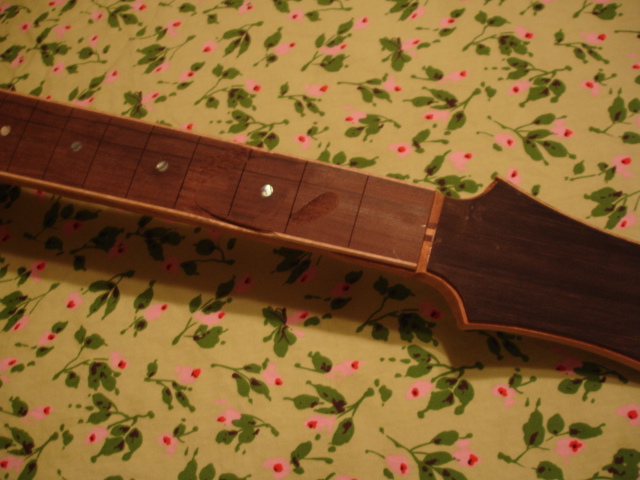

Well, it wasn't a shark but it sure looks like it!
A lesson well learned....never take your eyes away from your router

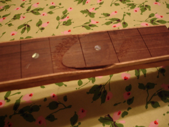

So here's what happened...I was routing my neck flush with the fingerboard, everything went smooth as usual...until I lifted the routed of the fingerboard, looked around to see the floor covered with shavings, when I turned to put the router down and as I moved my arm towards the table...BAM I miss judged the distance and I hit the fingerboard with the router still spinning.....well I guess t he pictures tell the rest of the story....
So I guess the best thing to do is remove the fingerboard and glue on another one.
I was lucky, after all the neck is still intact
Any suggestions for the easiest way to remove the fingerboard? It was glued with titebond yesterday..
Thanks again,

I put a towel down on a work bench, lay my heat blanket on it, clamp the neck to the blanket (face down of course) an in about 5 minutes you should be able to unclamp it and peel it right up with a putty knife.
You may then want to clamp the neck to a known flat surface while it cools. Just put a piece of wax paper down so the glue residue doesn't rebond to the clamping surface.

This is why the OLF is the best place on the web!
Thanks to Brock's advise I had the fingerboard off the neck and the eck cleaned in less than 10 mins! and to think I was going to use a clothes iron?
Thanks again...
